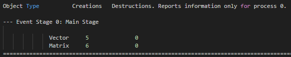

Dear PETSc community,
I am using the PETSc API petsc4py and I am interested in profiling the number of PETSc objects created during the run of my script.
I have used the -log_view option to get information on the run in a dedicated file, and I got this (among other infirmation):
[cid:image001.png at 01DBDA0D.D4F90080]
This is precisely the information I am interested in, but here only the process 0 is tracked.
I is possible to have the same type of information for all the processes? I went through the documentation and was not able to figure it out.
You want to access
  https://urldefense.us/v3/__https://petsc.org/main/manualpages/Log/PetscLogState/__;!!G_uCfscf7eWS!cDXOAoWknEhkWKDx0ghSlgUUMywVuLUCTz5sHEaHAVIJB_gsVlwjIfTb3qCF-mlz87Pdu0YEgddFhM80kaKVUDU_2z4ZrUvnN4K-TsOjuw$
which you get using
  https://urldefense.us/v3/__https://petsc.org/main/manualpages/Log/PetscLogGetState/__;!!G_uCfscf7eWS!cDXOAoWknEhkWKDx0ghSlgUUMywVuLUCTz5sHEaHAVIJB_gsVlwjIfTb3qCF-mlz87Pdu0YEgddFhM80kaKVUDU_2z4ZrUvnN4LDDoJ1Ng$
   Thanks,
     Matt
