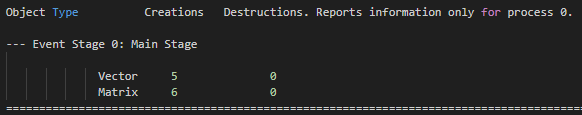

> Dear PETSc community,
> I am using the PETSc API petsc4py and I am interested in profiling the
> number of PETSc objects created during the run of my script.
> I have used the -log_view option to get information on the run in a
> dedicated file, and I got this (among other infirmation):
> This is precisely the information I am interested in, but here only the
> process 0 is tracked.
> I is possible to have the same type of information for all the processes?
> I went through the documentation and was not able to figure it out.
You want to access
  https://urldefense.us/v3/__https://petsc.org/main/manualpages/Log/PetscLogState/__;!!G_uCfscf7eWS!YfTSxLTF2TerpXGAhCfoL7bYAcosI6xV6JXwYXOjaVkt88NjAYm_-_WFn7x-IoWWTraAZ1iXE8ZCAY8QEn26$
which you get using
  https://urldefense.us/v3/__https://petsc.org/main/manualpages/Log/PetscLogGetState/__;!!G_uCfscf7eWS!YfTSxLTF2TerpXGAhCfoL7bYAcosI6xV6JXwYXOjaVkt88NjAYm_-_WFn7x-IoWWTraAZ1iXE8ZCASEp9DWe$
