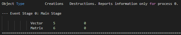

On Tue, Jun 10, 2025 at 7:44 AM SCOTTO Alexandre <
alexandre.scotto at irt-saintexupery.com> wrote:
> Hello Mat,
> Thanks for your answer. I think this object is not available in petsc4py,
> at least I do not see any related elements in the documentation
> https://urldefense.us/v3/__https://petsc.org/main/petsc4py/reference/petsc4py.PETSc.html__;!!G_uCfscf7eWS!cksrPnF_zRr19WbGYSajXPttTjWjk6YeKgg0Gp8Lk-nyTXp1XdibretqDhGHAAPWTauMuS1SLlgxba-1ldY8$
> So maybe this is not accessible in Python.
Yes, it looks like the new LogHandler interface, necessary for nested
logging like flamegraphs, is not in petsc4py. We will have to add it.
  Thanks,
     Matt

> Dear PETSc community,
> I am using the PETSc API petsc4py and I am interested in profiling the
> number of PETSc objects created during the run of my script.
> I have used the -log_view option to get information on the run in a
> dedicated file, and I got this (among other infirmation):
> This is precisely the information I am interested in, but here only the
> process 0 is tracked.
> I is possible to have the same type of information for all the processes?
> I went through the documentation and was not able to figure it out.
> You want to access
>   https://urldefense.us/v3/__https://petsc.org/main/manualpages/Log/PetscLogState/__;!!G_uCfscf7eWS!cksrPnF_zRr19WbGYSajXPttTjWjk6YeKgg0Gp8Lk-nyTXp1XdibretqDhGHAAPWTauMuS1SLlgxbRt_afMq$
> which you get using
>   https://urldefense.us/v3/__https://petsc.org/main/manualpages/Log/PetscLogGetState/__;!!G_uCfscf7eWS!cksrPnF_zRr19WbGYSajXPttTjWjk6YeKgg0Gp8Lk-nyTXp1XdibretqDhGHAAPWTauMuS1SLlgxbelDML9w$
>    Thanks,
>      Matt
