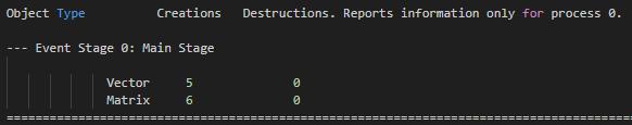

Dear PETSc community,
I am using the PETSc API petsc4py and I am interested in profiling the number of PETSc objects created during the run of my script.
I have used the -log_view option to get information on the run in a dedicated file, and I got this (among other infirmation):
[cid:image001.png at 01DBD9FB.09669CA0]
This is precisely the information I am interested in, but here only the process 0 is tracked.
I is possible to have the same type of information for all the processes? I went through the documentation and was not able to figure it out.
