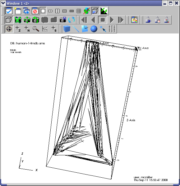

Hi All,
Ok, I copied /usr/local/itaps/FMDB_iMeshP to my home dir, re-configured
and compiled it and 'installed' it to /usr/local/itaps/visit/fmdb.
Then, I build VisIt's plugin against it and installed the resulting
plugin /usr/local/itaps/visit.
However, it does not draw the test files correctly. It looks like there
is a problem with connectivity. A picture is attached.
Mark
