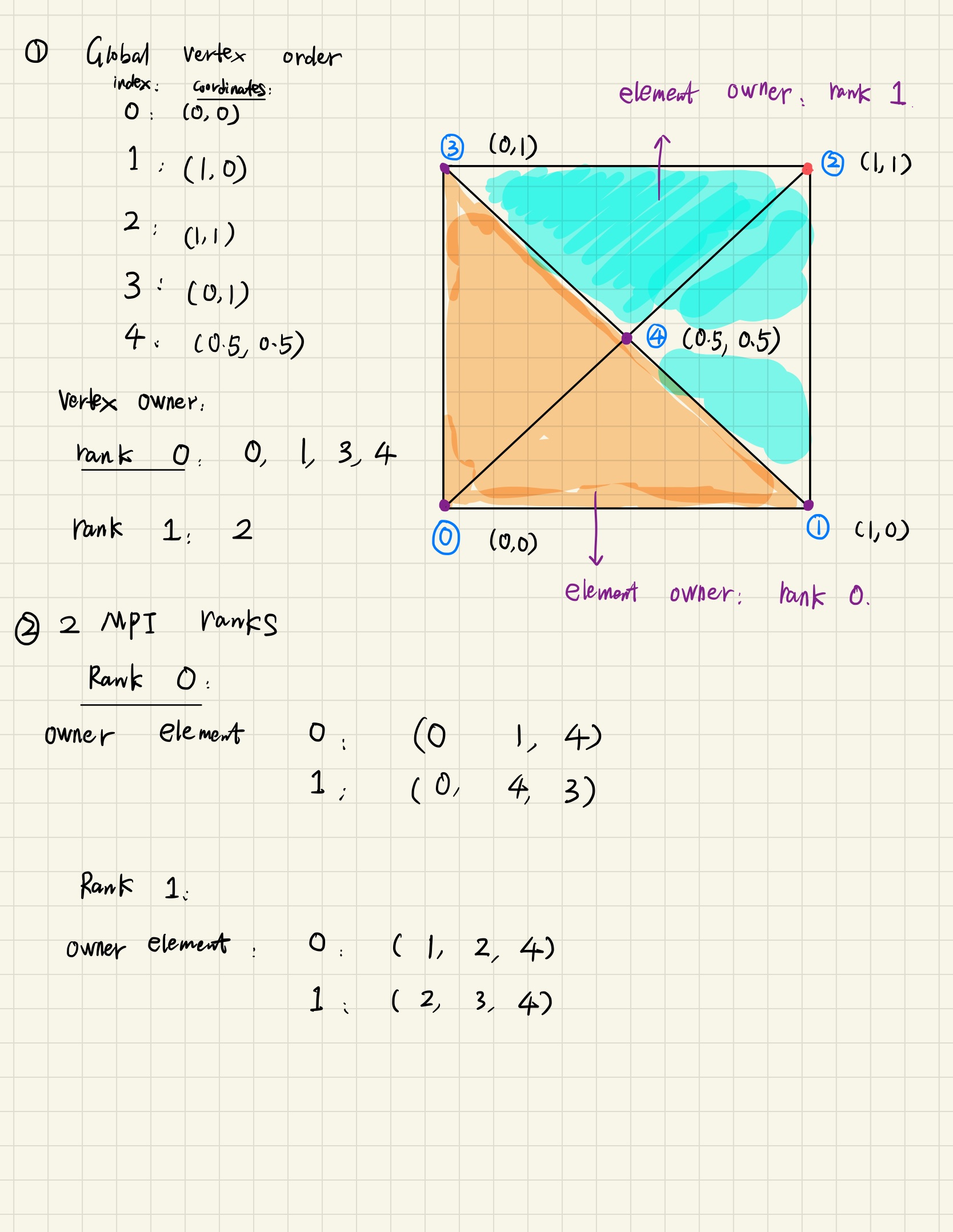

Thank you for your help with this missing information. This solved the issue. Looking at the manual again for DMPlexBuildFromCellListParallel (internal function being called, https://urldefense.us/v3/__https://petsc.org/release/manualpages/DMPlex/DMPlexBuildFromCellListParallel/__;!!G_uCfscf7eWS!fmyMzLlbHCS_e22XlTJPzQcOaVEWo_GQ0mCMiB_G5VBovdxOfFs0mqg7g_0rox9TP8iRN_VBCeL74-xIX_Zf1aPcEnI03ePX$ ), it did state that: “Each process owns a chunk of numVertices consecutive vertices.”, which may be implying what you said, and I missed that important information.

I think you need to reorder your points according to each processor.
If process 0 has 4 vertices, they will be numbered (0, 1, 2, 3), and if proc 1 has one vertex it will be 4.
So, to fix this, switch vertex numbering for 2 and 4.
Mark

I have some questions on the proper use of DMPlexCreateFromCellListParallelPetsc function (https://urldefense.us/v3/__https://petsc.org/release/manualpages/DMPlex/DMPlexCreateFromCellListParallelPetsc/__;!!G_uCfscf7eWS!fmyMzLlbHCS_e22XlTJPzQcOaVEWo_GQ0mCMiB_G5VBovdxOfFs0mqg7g_0rox9TP8iRN_VBCeL74-xIX_Zf1aPcEqZ4IMoI$ <https://urldefense.us/v3/__https:/petsc.org/release/manualpages/DMPlex/DMPlexCreateFromCellListParallelPetsc/__;!!G_uCfscf7eWS!YJgdfNvYGp76m3zAsH07tAaJCaPnEyuyhZdGILGu2oyhW0RSJZeX4J8-IUCVNBupO7efr7Ju5zA_5ayjZ_YkwEeCuXjIJQ2K$>). I am upgrading my code’s PETSc dependency from v3.16.6 to v3.24.0 (and v3.23.3, v3.23.6). I encountered crash with DMPlexCreateFromCellListParallelPetsc function:
·      To show the crash, I modified the following test: src/dm/impls/plex/tests/ex18.c
·      Is there anything I am doing wrong when creating DMPlex using the below mesh with this test?
·      What is the order of vertex index (of own element) going into DMPlexCreateFromCellListParallelPetsc function?
·      What is the order of own vertex coordinates going into DMPlexCreateFromCellListParallelPetsc function?
Here is a detailed descriptions of what I did with ex18.c to show my issue: src/dm/impls/plex/tests/ex18.c
·      A simple 2D square mesh with 5 vertices and 4 triangles, shared by 2 MPI ranks (see the below image for the mesh, also attached file).
·      Each MPI rank owns 2 elements.
·      MPI rank 0 owns vertex indexed as: 0, 1, 3, 4; rank 1 owns vertex indexed as: 2.
·      Modified code (with updated mesh information) is attached.
·      The DM view output is also attached.
·      Note: the original test with 2 triangles and 2 elements was running fine.
[cid:ii_199bb9d3c9b4ce8e91]
