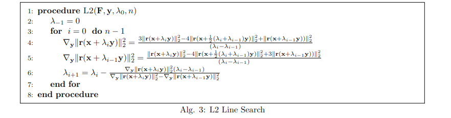

For example, when using L2 algorithms where a different norm is applied in the line search, see Line_search_L2.png as an example from this reference: [ https://urldefense.us/v3/__https://arxiv.org/abs/1607.04254__;!!G_uCfscf7eWS!foyayF7qjdgruME_ERnNpzgxCXcAQdMKzZwZ_YYvujvBhUanj58QBYDvgRLjJcQJaSKIm0g8PhcP2pO29_j2D5o_WJgD5Q$  | https://urldefense.us/v3/__https://arxiv.org/abs/1607.04254__;!!G_uCfscf7eWS!foyayF7qjdgruME_ERnNpzgxCXcAQdMKzZwZ_YYvujvBhUanj58QBYDvgRLjJcQJaSKIm0g8PhcP2pO29_j2D5o_WJgD5Q$  ] . Here, we can change the norm from the L2 Euclidean to the L2 Lebesgue norm.
    * For GMRES, we need to replace NORM_2 (L2 Euclidean) in your code with weighted_NormL2 (L2 Lebesgue) everywhere, including all the details such as in the Arnoldi algorithm...
For the convergence test as well, in the linear system for finding the direction d (A · d = b), and also when we search for a good step using the line search formula: x k + 1 ​ = x k ​ + step × d .
