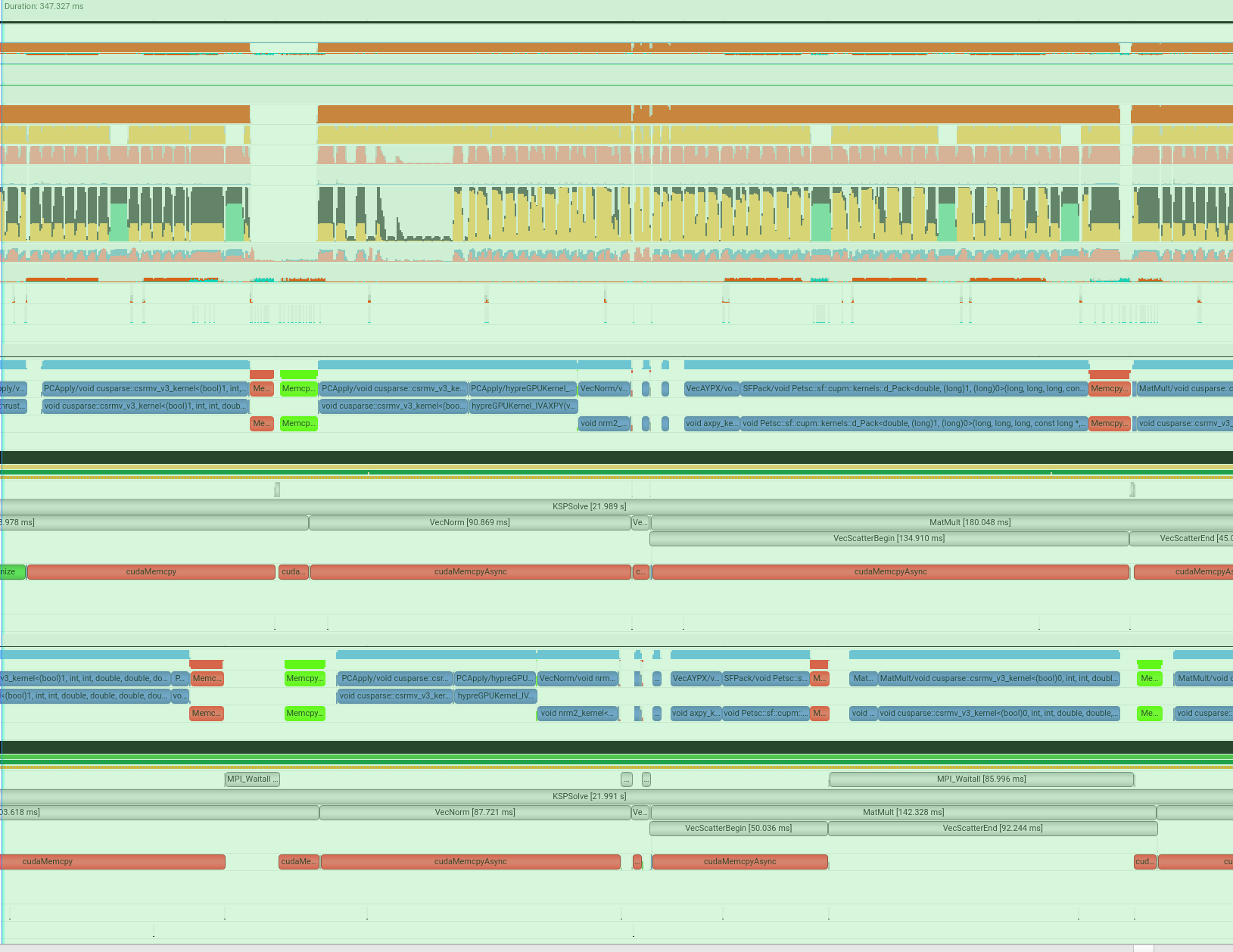

My code is built with PETSc 3.23+OpenMPI 4.1.6 (Cuda support enabled) and profling indicates that MPI communications are done between GPUs in all the code except PETSc part where D2H transfers occur.
I reproduced the PETSc issue with the example under src/ksp/ksp/tutorials/ex10 on 2 MPI ranks. See output in ex10.log
Also below the Nsys system profiling on ex10 with D2H and H2D copies before/after MPI calls.
