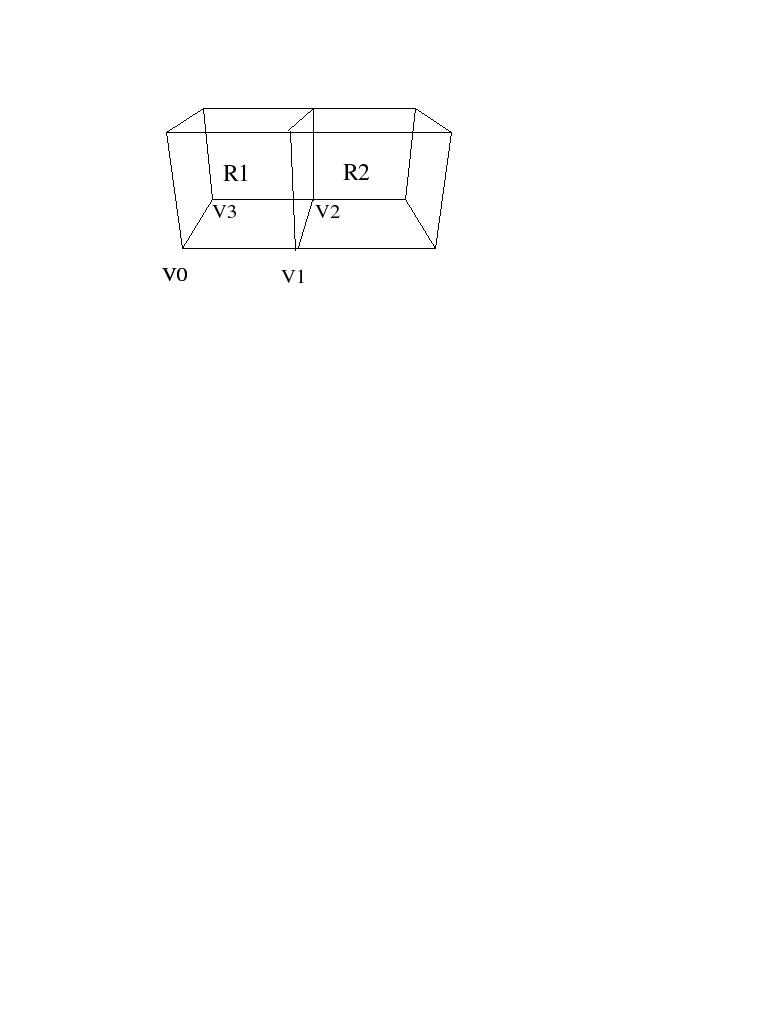

Hi Jason,
We still do not know what are indices of adjacent entities in the new
proposed function. Thus we make a simple example to demonstrate the
problem, and try to clarify what are the inputs and outputs. Please
correct me if you find any mistakes. Thanks.
The attached is a simple mesh picture of two adjacent hexes. We call
iMesh_getAdjEntIndices to get two following requests.
 1. To get adjacent edge indices for the hexes
  INPUT: type=region, topo=hex, adj_type=edge
  OUTPUT:
    hex_handles: H1, H2
    adj_edge_handles: e1, e2, ..., e12, e1', e2', ..., e12'
    adj_indices: 1, ..., 12, 1', 2', ..., 12'
    offset: 0, 12, 24
 2. To get adjacent vertex indices for the hexes
 INPUT: type=region, topo=hex, adj_type=vertex
 OUTPUT:
    hex_handles: H1, H2
    adj_edge_handles: v1, v2, ..., v8, v1', v2', ..., v8'
    adj_indices: 1, ..., 8, 1', 2', ..., 8'
    offset: 0, 8, 16
Since we do not know what are adj_indices. We guess that it has two options:
  (1) 1,..., 8
(The order of adjacent edges local to the hex, should that start from 0 or
1? If this is the case, we do not have any problem. )
  (2) the unique integer ids of the edges in the mesh
(If mesh database has dynamic storage because of mesh modification, like
FMDB, and it does not store the unique ids for entities, what should
return in the adj_indices array? )
Thanks,
Ting

>> 5. Item #7
>>      New function: iMesh_isEntArrContained, raised from Item #6. It is
>> an
>> array version for iMesh_isEntContained.
> And the issue with this is...?
> - jason
