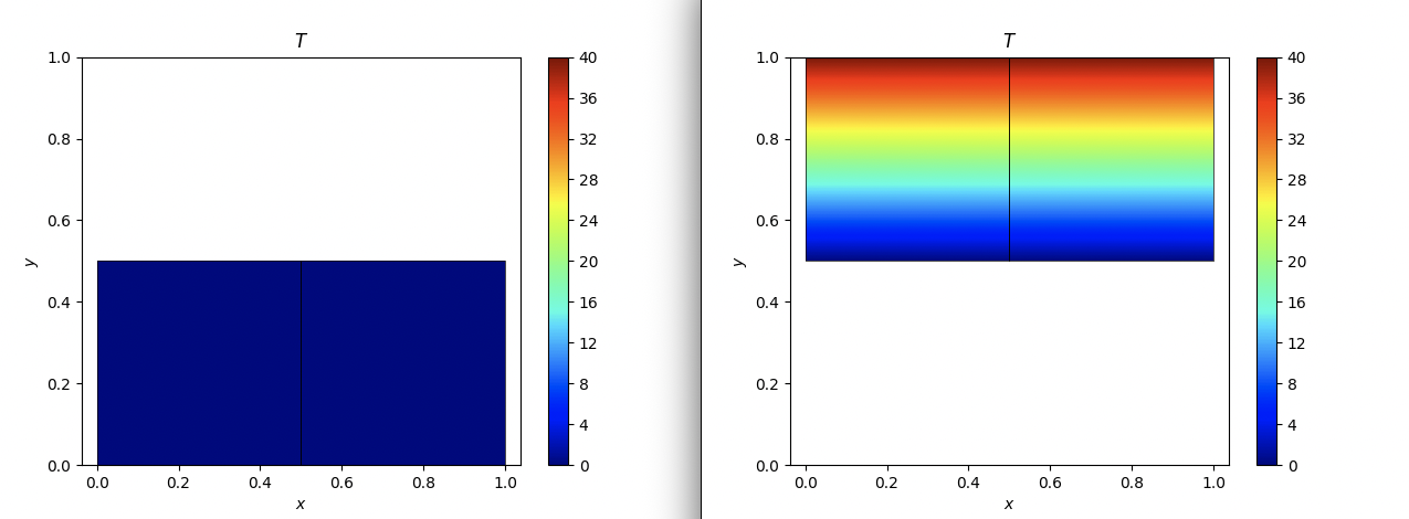

I am currently working on *Issue #26*
(https://urldefense.us/v3/__https://github.com/matnoel/EasyFEA/issues/26__;!!G_uCfscf7eWS!flSI4RbIKcgCgsNyOejSxJzr9vPWftTgzTVo2hSxHxa1AjYCAMppGknY5M5EGs9muBjuX4s8jfd0PCpQUkoOjKZWmhF-Su0$ ), where I aim to use
*petsc4py* to solve a simple stationary thermal problem in parallel.
The main challenge is *constructing and solving the parallel matrix
system* (|Ax = b|).
      Current Status:
  * *Mesh partitioning* has been successfully performed using *GMSH*.
  * EasyFEA provides the *assembled matrix system* (|Ax = b|) with
    applied boundary conditions.
  * My current implementation using *petsc4py* runs without errors, but
    the results obtained are incorrect.
I suspect the problem lies in how the *parallel matrix and vectors are
assembled or solved*, particularly in handling *ghost DOFs* and ensuring
proper communication between MPI ranks.
I would be extremely grateful for any guidance, resources, or examples
you could share to help me address this issue.
My current development branch is available here:
https://urldefense.us/v3/__https://github.com/matnoel/EasyFEA/tree/26_mpi__;!!G_uCfscf7eWS!flSI4RbIKcgCgsNyOejSxJzr9vPWftTgzTVo2hSxHxa1AjYCAMppGknY5M5EGs9muBjuX4s8jfd0PCpQUkoOjKZWW8q1-8I$ .
The PETSc function can be found at this link:
https://urldefense.us/v3/__https://github.com/matnoel/EasyFEA/blob/26_mpi/EasyFEA/Simulations/Solvers.py*L649-L767__;Iw!!G_uCfscf7eWS!flSI4RbIKcgCgsNyOejSxJzr9vPWftTgzTVo2hSxHxa1AjYCAMppGknY5M5EGs9muBjuX4s8jfd0PCpQUkoOjKZWlmD8DH8$
I am currently running the script in the attached files.
Thank you in advance for your time and expertise.
