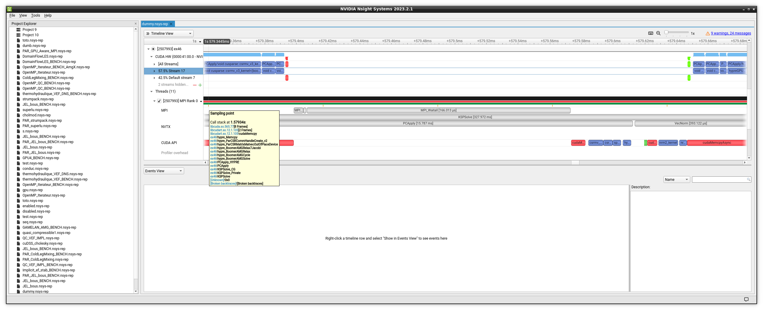

For instance on the below graphic, there is a sequence:
[cid:c0738ea8-66fe-4bae-aeb0-3cb66f6bfeb4]
Blue: PCApply/spmv_fixup_kernel_v2
Red: D2H copy (8000 bytes)
Grey: MPI_irecv
Grey: MPI_isend
Grey: MPI_Waitall
Green: H2D copy (8000 bytes)
Blue: PCApply/csmv_v2_partition_kernel
And this is happening in Hypre code.
I replaced boomeramg by gamg, and confirm now there is only D2D copy during MPI calls. So the issue is related to Hypre (using 2.33).

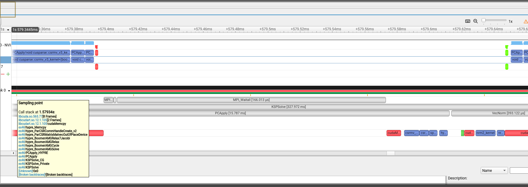

It solved the unrecognized option but still exchanging MPI messages through the host.
I switch to a simpler test case without reading a matrix (src/ksp/ksp/tutorials/ex46.c) but get the same behaviour.
In the Nsys profile for ex46, the MPI synchronizations occurs during PCApply so now I am wondering if the issue is related to the fact than Hypre is not configured/enabled with MPI GPU-Aware in the PETSc build.
I will give a try with --enable-gpu-aware-mpi passed to Hypre.
