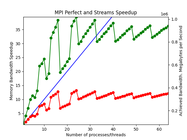

Attached is a petsc streams result kindly provided by a hardware
vendor for a single compute node, dual socket, with two AMD epyc
9355 processors. Each processor has 32 cores, 12 DDR5 memory
channels and mem BW around 600 GB/s.
* It is not immediately clear which line corresponds to which
  y-axis. Could future versions of petsc please color the axis
  label with the matching line color?
* Why would the achieved bandwidth be roughly 0.9 x 1e6 MB/s =
  900 GB/s and not closer to 1200 GB/s?
* The speed-up seems to be 12 out of 64, provided multiples of 8
  cores are used. As expected given 12 memory channels?
* Does the zig-zag pattern indicate a pinning problem, or is it
  unavoidable given the 8 core building block of these type of
  processors?
