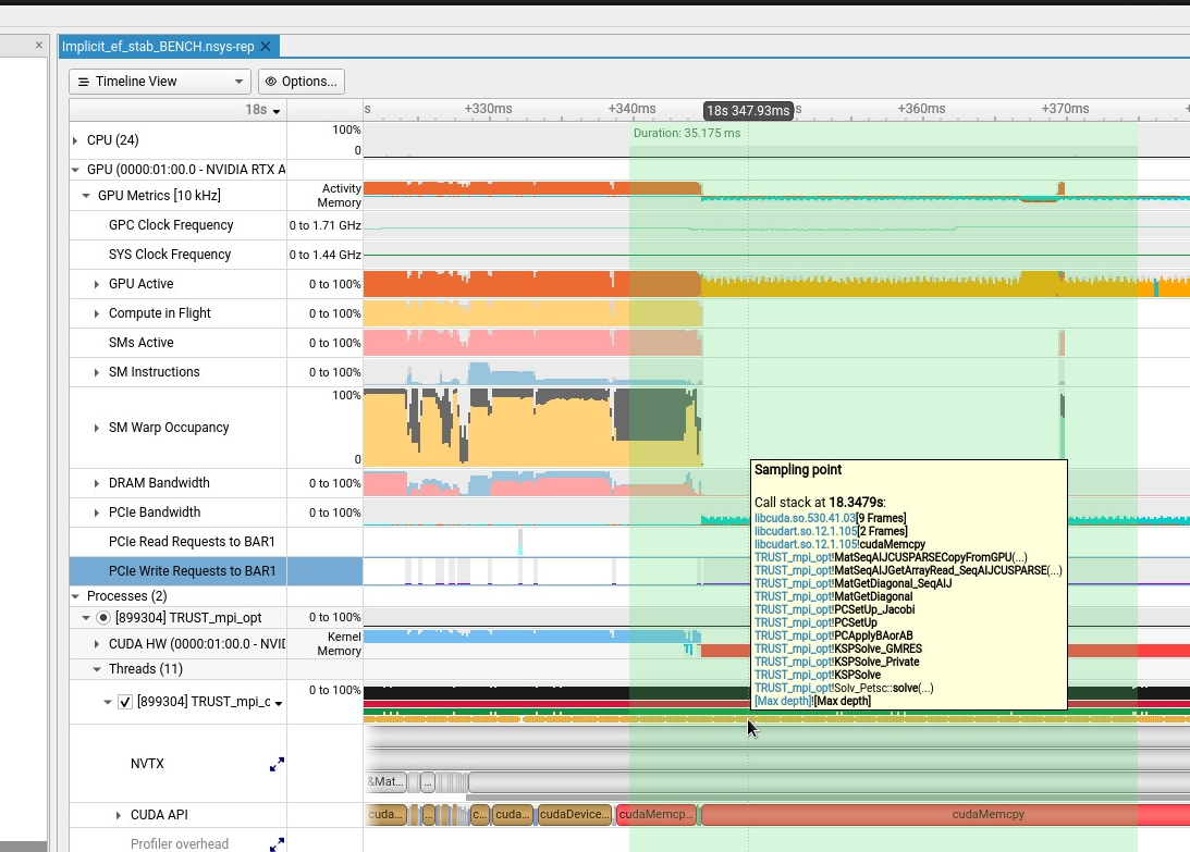

> Yes, MatGetDiagonal_SeqAIJCUSPARSE hasn't been implemented.  petsc/cuda
> and petsc/kokkos backends are separate code.
> If petsc/kokkos meet your needs, then just use them.  For petsc users, we
> hope it will be just a difference of extra --download-kokkos
> --download-kokkos-kernels in configuration.

>> It is working fine with a GMRES Ksp solver and PC Jacobi but we are
>> surprised to see that every time step, during PCSetUp,
>> MatGetDiagonal_SeqAIJ is called whereas the matrix is on the device.
>> Looking at the API, it seems there is no MatGetDiagonal_SeqAIJCUSPARSE()
>> but a MatGetDiagonal_SeqAIJKOKKOS().
>> Does it mean we should use Kokkos backend in PETSc to have Jacobi
>> preconditioner built directly on device ? Or I am doing something wrong ?
>> NB: Gmres is running well on device.
