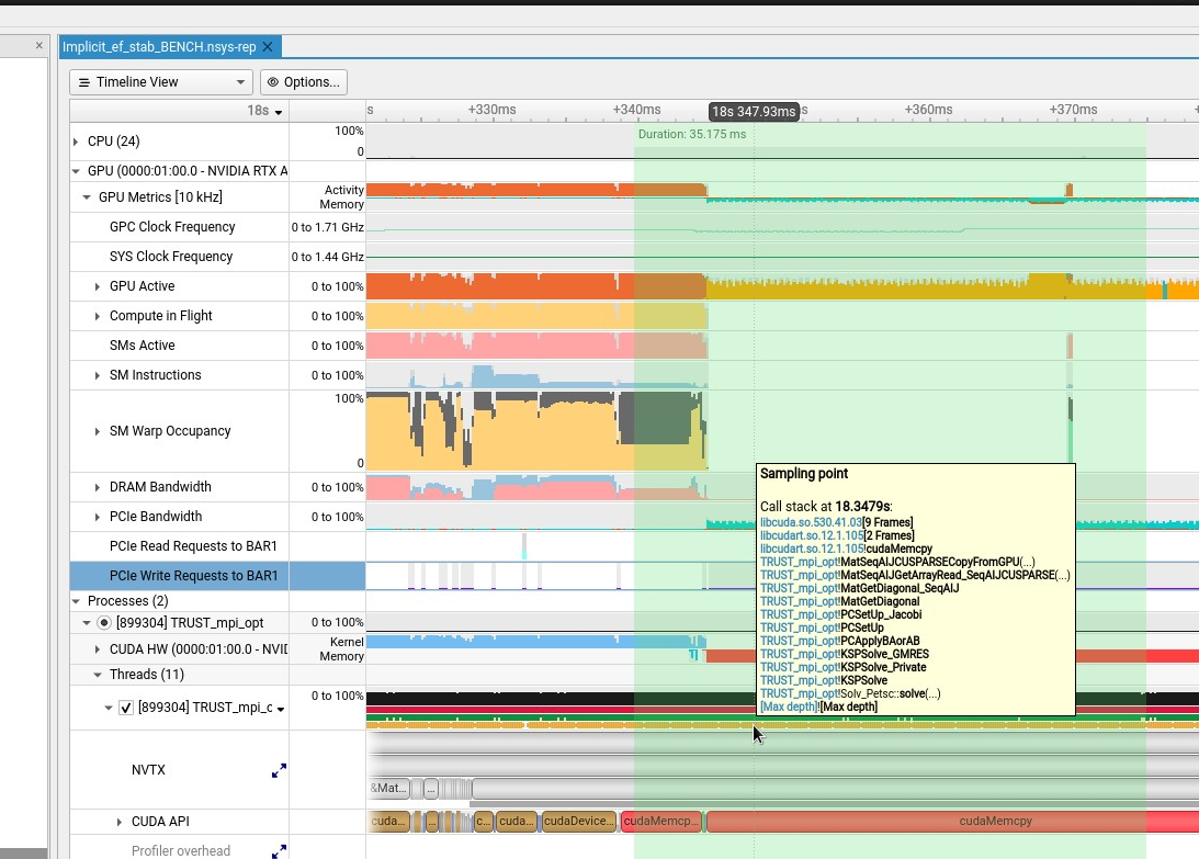

Yes, MatGetDiagonal_SeqAIJCUSPARSE hasn't been implemented.  petsc/cuda and
petsc/kokkos backends are separate code.
If petsc/kokkos meet your needs, then just use them.  For petsc users, we
hope it will be just a difference of extra --download-kokkos
--download-kokkos-kernels in configuration.

> Hello all,
> We are solving with PETSc a linear system updated every time step
> (constant stencil but coefficients changing).
> The matrix is preallocated once with MatSetPreallocationCOO() then filled
> each time step with MatSetValuesCOO() and we use device pointers for
> coo_i, coo_j, and coefficients values.
> It is working fine with a GMRES Ksp solver and PC Jacobi but we are
> surprised to see that every time step, during PCSetUp,
> MatGetDiagonal_SeqAIJ is called whereas the matrix is on the device.
> Looking at the API, it seems there is no MatGetDiagonal_SeqAIJCUSPARSE()
> but a MatGetDiagonal_SeqAIJKOKKOS().
> Does it mean we should use Kokkos backend in PETSc to have Jacobi
> preconditioner built directly on device ? Or I am doing something wrong ?
> NB: Gmres is running well on device.
> I could use -ksp_reuse_preconditioner to avoid Jacobi being recreated each
> solve on host but it increases significantly the number of iterations.
