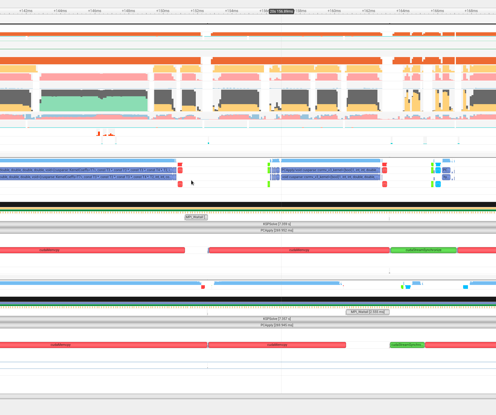

Ok, I just tried --enable-gpu-aware-mpi passed to Hypre,
Hypre_config.h defines now HYPRE_USING_GPU_AWARE_MPI 1
But still no D2D copy near MPI calls in ex46.c example.
Probably an obvious thing I forgot during PETSc configure, but I don't see...

Barry,
It solved the unrecognized option but still exchanging MPI messages through the host.
I switch to a simpler test case without reading a matrix (src/ksp/ksp/tutorials/ex46.c) but get the same behaviour.
In the Nsys profile for ex46, the MPI synchronizations occurs during PCApply so now I am wondering if the issue is related to the fact than Hypre is not configured/enabled with MPI GPU-Aware in the PETSc build.
I will give a try with --enable-gpu-aware-mpi passed to Hypre.
Do you know an example in PETSc which specifically bench with/without Cuda-Aware enabled for MPI ?

On Aug 30, 2025, at 1:16 PM, LEDAC Pierre <Pierre.LEDAC at cea.fr<mailto:Pierre.LEDAC at cea.fr>> wrote:
Hello,
My code is built with PETSc 3.23+OpenMPI 4.1.6 (Cuda support enabled) and profling indicates that MPI communications are done between GPUs in all the code except PETSc part where D2H transfers occur.
I reproduced the PETSc issue with the example under src/ksp/ksp/tutorials/ex10 on 2 MPI ranks. See output in ex10.log
Also below the Nsys system profiling on ex10 with D2H and H2D copies before/after MPI calls.
Thanks for your help,
