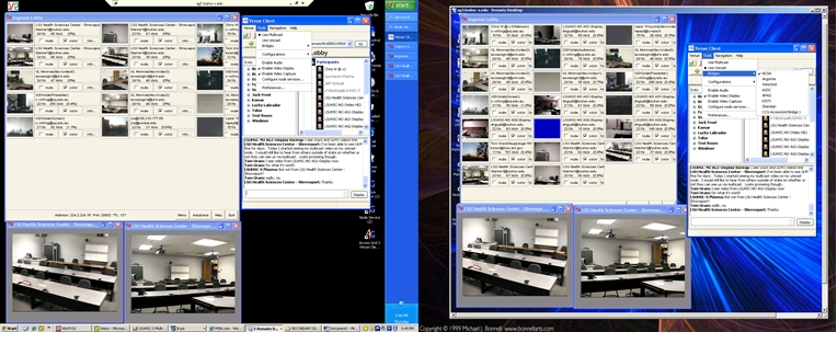

I have attached a snapshot of my multicast and unicast nodes.  The image
on the left is the multicast node and the one on the right is the
unicast node.  The images at the bottom show that I am sending/receiving
video from my nodes.
