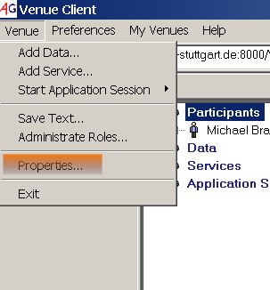

My mistake, it is labeled Venue. I attached a screen shoot where to find the
properties for AGT 2.3.
Besides I would advise you to use AGT 2.3 as there are a lot of bugfixes

> Basically you can just connect to the room you want the mc-address and
> ports
> from and once the AG-VenueClient connected you can view the address and
> ports by opening the venue properties in File->Properties
> This gives you the data for the mc-address for the room. The unicast port
> mapping to these multicast ports are bridge dependent and can be
> configured
