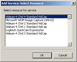

It's also worth checking device manager as well. If you look at the attached image (Video-Devices.gif), you'll see that your multi-input capture card should either appear as 4 separate Imaging Devices, or as a Video Controller.
Can you confirm what you see when you try to add a Video Producer. If you see the other attached image (Video-Producer.gif) you'll see my webcam (Logitech Quickcam), the 4 Winnov Videum inputs and also the Microsoft WDM Image Capture. I believe that this addition Microsoft item is the result of the OS installing its own device driver for the webcam. It shouldn't do this for any specialist capture devices, i.e. those made by Pinnacle, Winnov etc...so I wouldn't choose it. You should choose the device applicable to the driver name.

After a few more trys with Fedora 9 i just gave up and installed Windows XP but i got new annoying issues, seems my Access Grid 3.1 installation can't recognize my video capturer devices.
First i installed them with the own drivers from Pinnacle and then i installed the open source ones (http://btwincap.sourceforge.net) but still the same problem.
I know this problem comes from the 2.4 version but i thought it was fixed in 3.1 versions but seems not or else im doing something wrong.
The only device i can get is called something like 'Microsoft WDM Image Capture (Win32)', then i add 4 of those, i connect to the venue, the 4 vics gets launched and well doesn't work at all as i get errors telling me that im trying to use the same device... OK, VIC itself recognizes the 4 cards but if i try to change the device i want to use there it just crashes... Checking old mails i got this link http://www-unix.mcs.anl.gov/web-mail-archive/lists/ag-tech/2005/04/msg00175.html
but, don't know if its fixed already for 3.1 or not, can anyone confirm this?.
